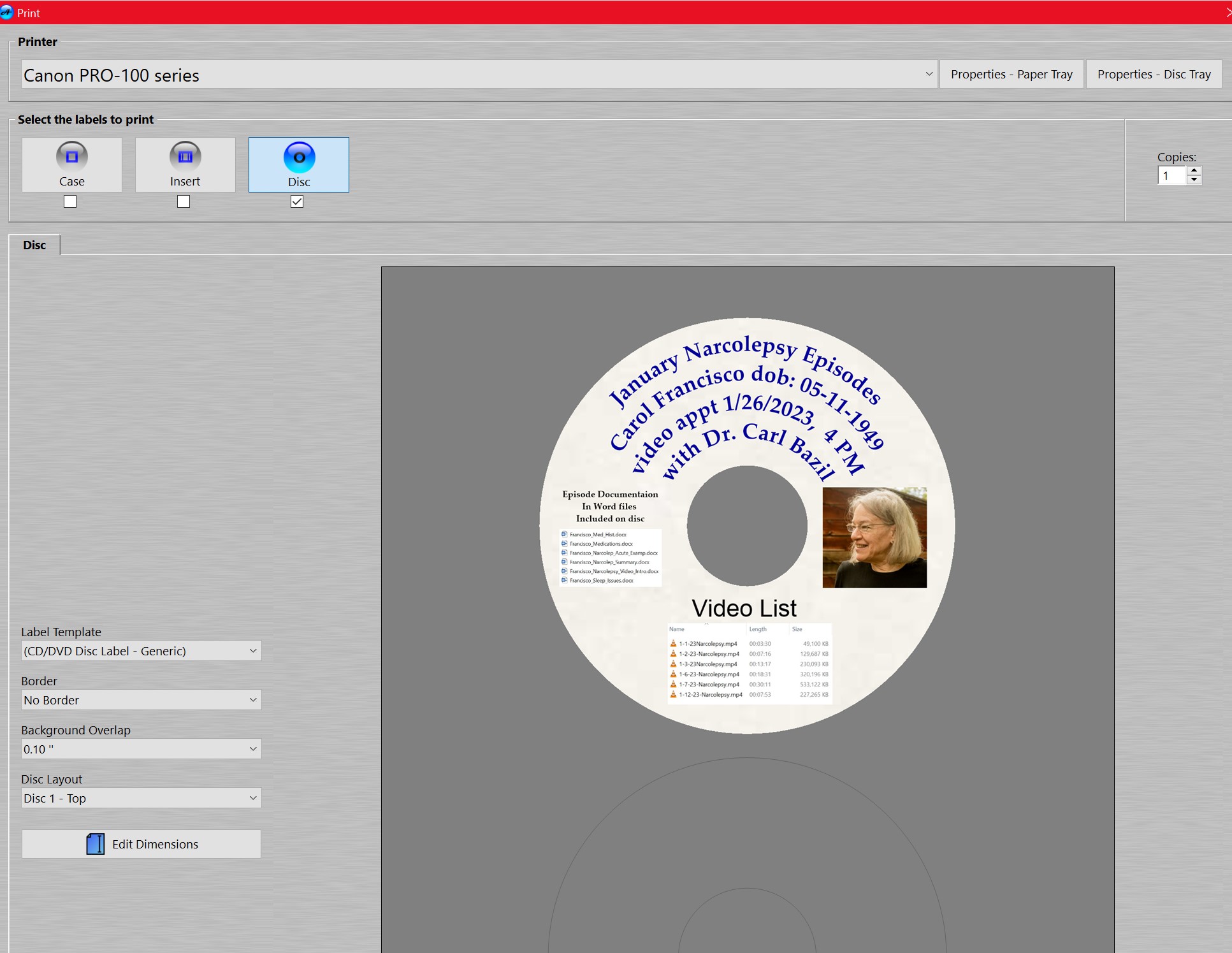

Am now looking at AudioLabel and able to do pretty much of the design I could with Epson CD Print. Printing with it so far hasn't put down any ink. I start with the print menu

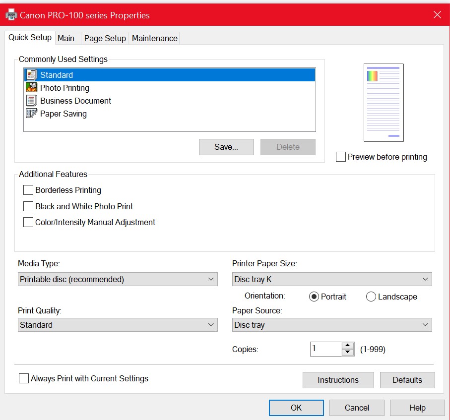

Then I get the printer config dialog windows which I've set like this

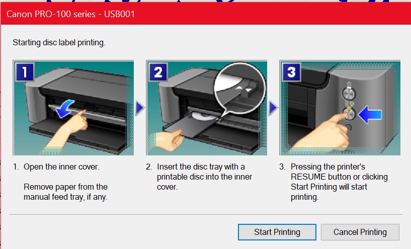

I then get another popup telling me to setup the CD tray....it looks like this:

Note that just as I set the printer to use the Tray K, (see bottom left) and the yellow light above the bottom right button is lit
The printer shuffles the tray in and out over a couple of minutes, but never prints anything and finally spits the tray out. No error message, no messages.

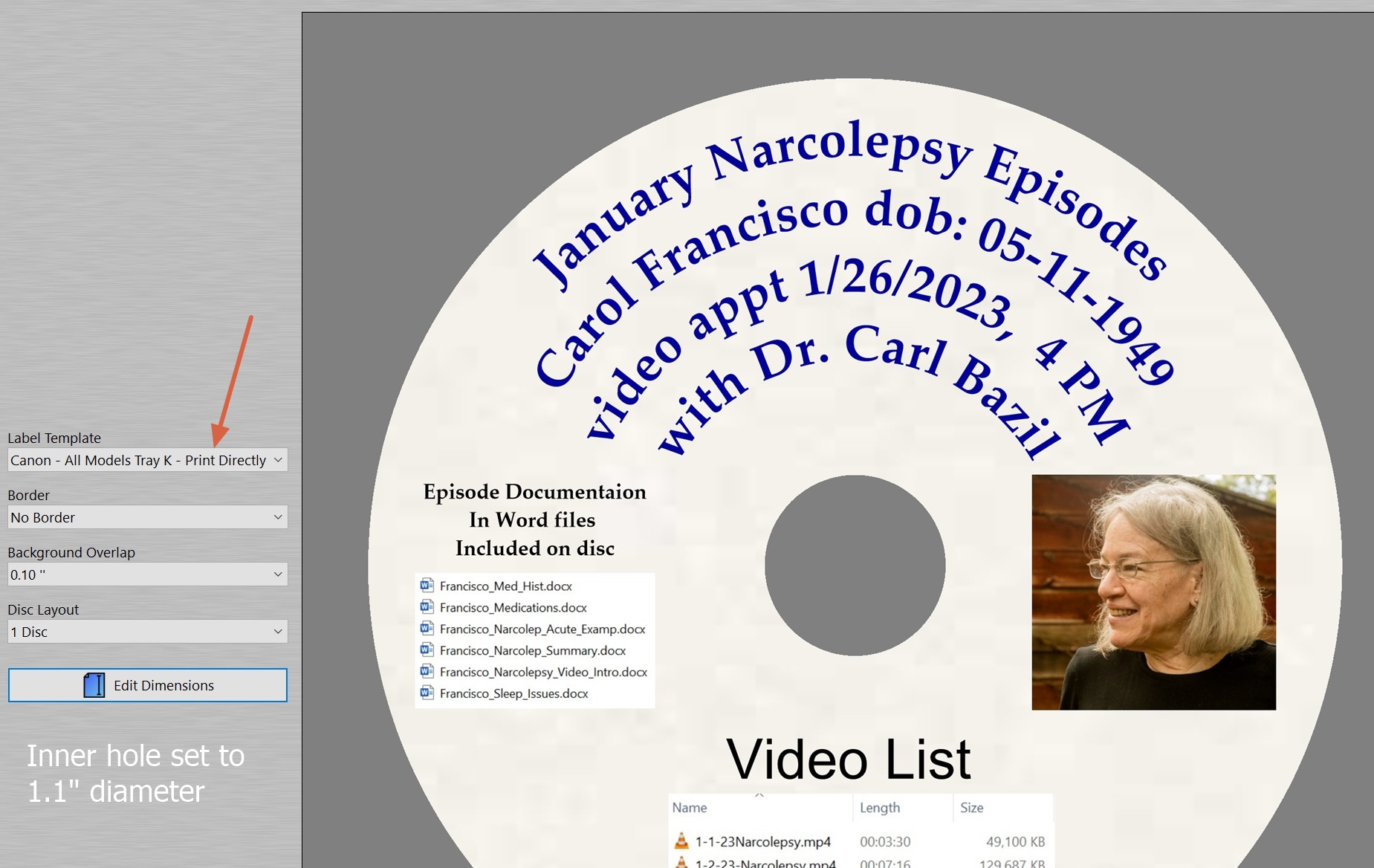

I mistook the default Label Template field, which is (CD/DVD Disk Label Generic), as works for everything. Once I realized it was selectable for a host of different printers (RTFM) and scrolled down to select Canon - All Models Tray K- Print Directly,, everything worked.

There is also a "Canon Pixma Pro-100 - Print Direct on CD" template
