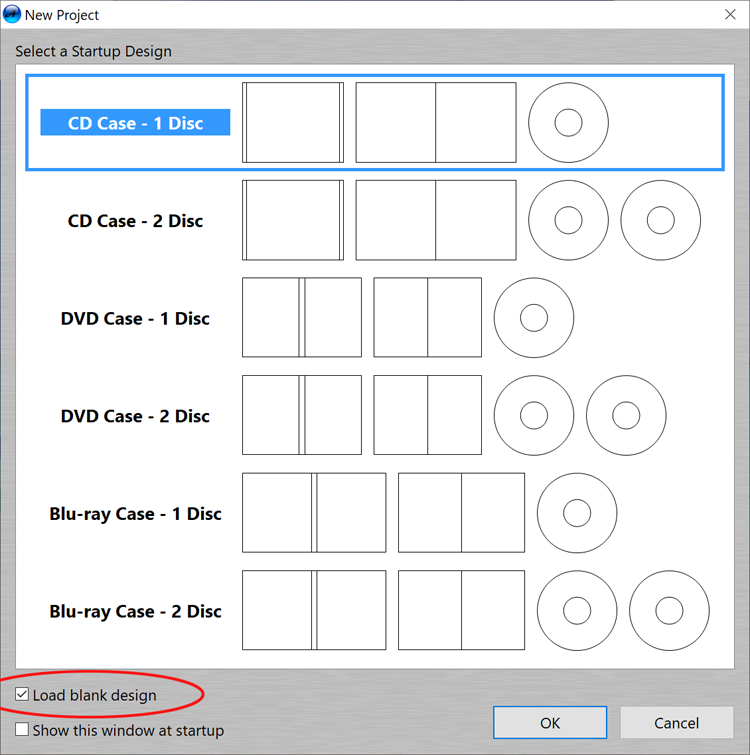

Blank Design.png (Viewed 8811 times)
Add a single piece of text to the label so you know where the top of the disc is.

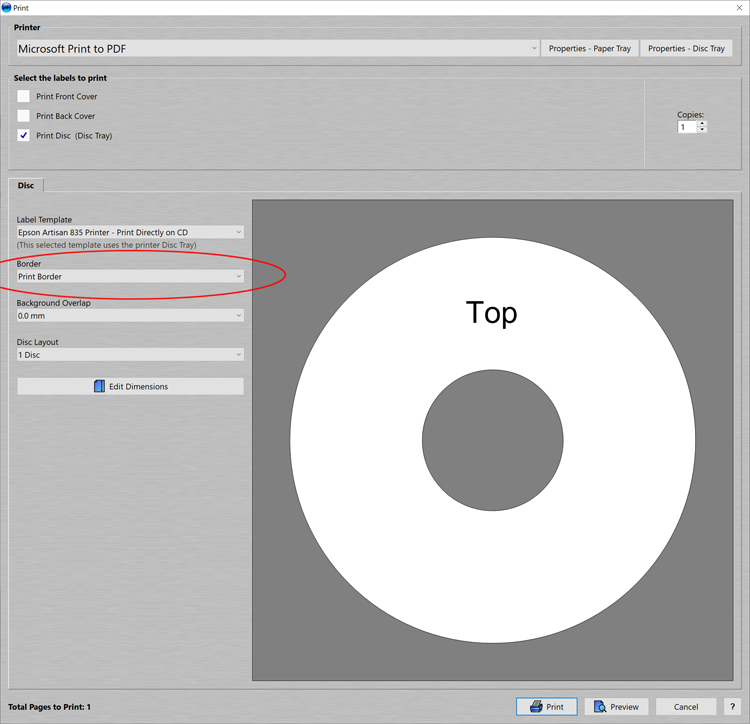

Next print to the disc with the "Print Border" option turned on:
Print Border.png (Viewed 8811 times)
After printing the disc you should see the disc border printed on the disc. From here measure how far the disc outline is from the edge. You can then edit the Left and Top dimensions of the Epson Artisan 835 Printer template based on these measurements. Repeat this process until perfect (you can probably use the same testing disc a few times).
