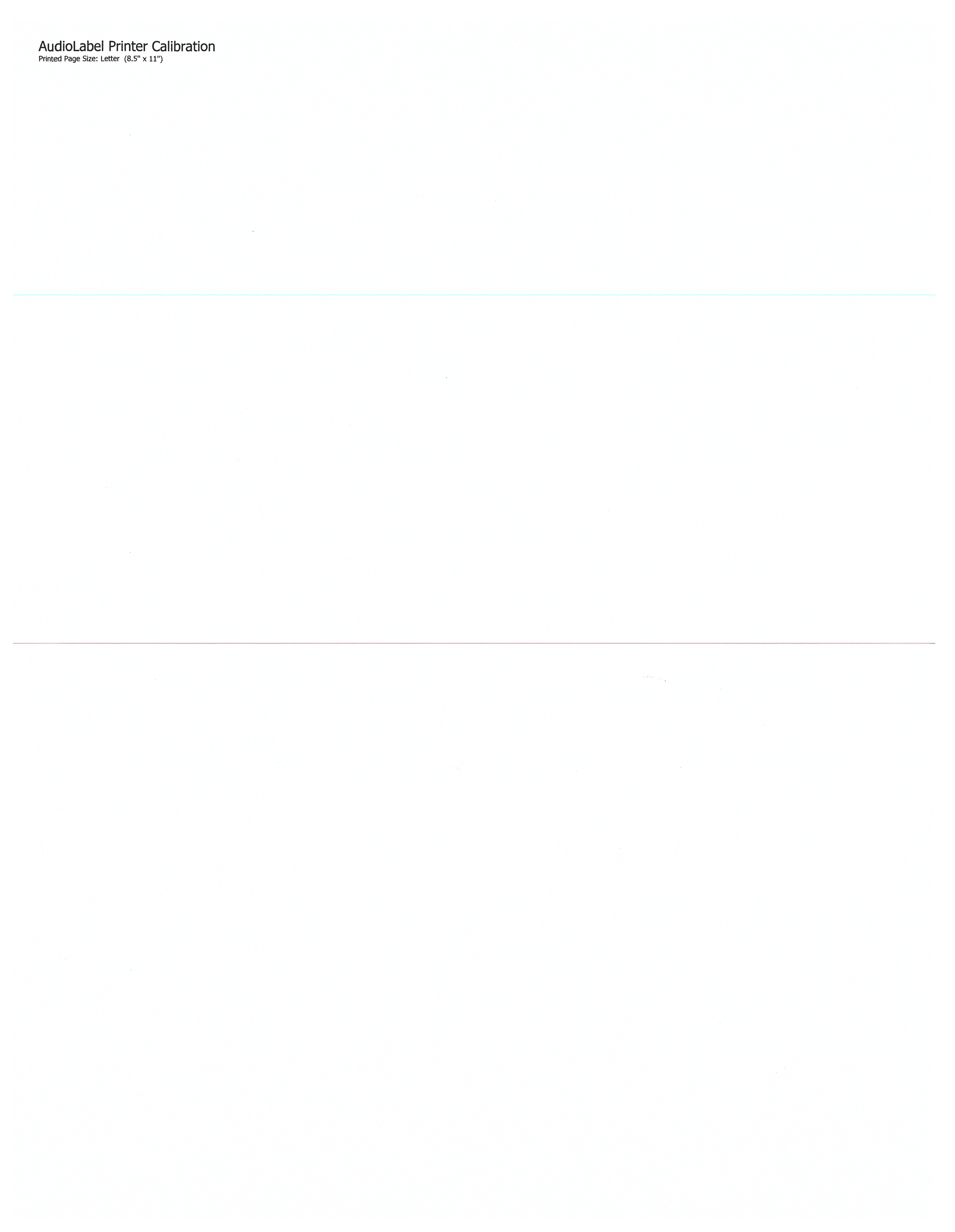

Postby Jhunt24648 » Wed Jan 02, 2019 1:58 pm
When using a Xerox driver (on both a WorkCentre 7835 and AltaLink C8055 from Win 7 and 10), the image is shrunk down into the upper left corner. the calibration page only prints the first two lines and the rest is blank. Happening on all full Xerox drivers, Class driver and generic driver work fine. Have tried a Xerox PCL, PCL6, PS and a Global Print Driver.

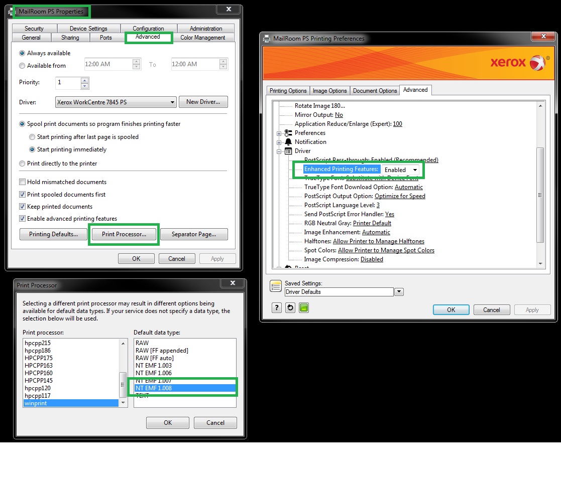

Postby Jhunt24648 » Thu Jan 03, 2019 11:34 am
If you change the Print Processor from RAW to NT EMF then it will print with no issue. Enhanced Printing Features has to be enabled to use EMF.
