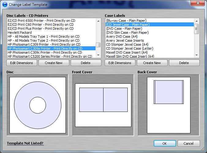

I have an HP Photosmart Premium C309a printer and keep trying to print on a Sony DVD with white face for image. I loaded the DVD onto slide in tray, dropped the CD/DVD tray down and inserted into the printer the slide in tray. I had prepared the image in Audio Label program. Then I pressed print and adjusted settings to reflect my HP model and CD/DVD tray as paper tray option. When all looked correct I hit print preview. Image displayed was correct, however it displayed on the lower half of what appears to be a possible 8 1/2" by 11" paper printout. When I hit print again, the printer locked up, asking me to raise the CD/DVD tray supports the CD/DVD slide in tray with the DVD that is used to prepare for the DVD printing. When I removed the slide in tray and lower the CD/DVD tray, the image then printed on paper.

The problem of printing to paper instead of the disc usually has to do with your print driver settings.
1. First, make sure you have selected the "HP Photosmart C309a Printer" template in the "Change Label Template" as shown below:

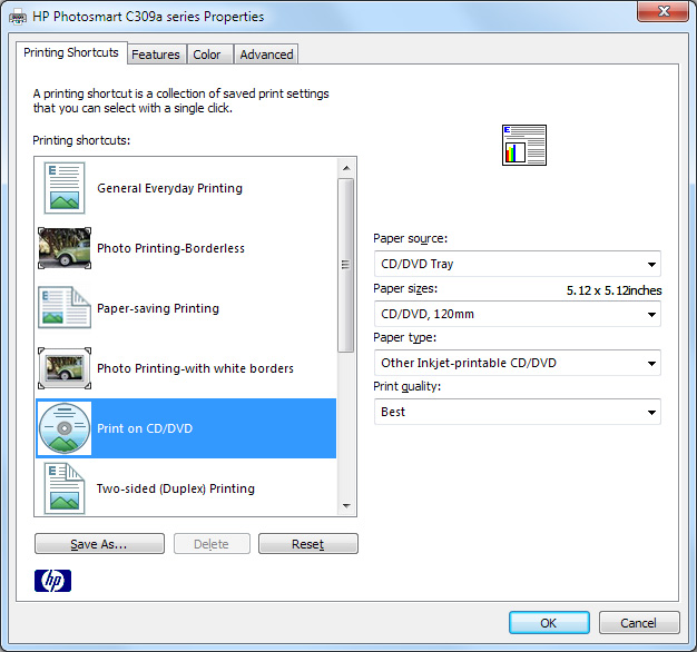

2. Next, go to the "Print" dialog in AudioLabel, click the "Printer Properties" button, and then the "Print Driver Properties" button under the Direct Disc Printing section.
3. Select the printer driver setting as shown below:
4. Once these settings are applied, AudioLabel should print directly to the disc.

Postby Mark Edenburn » Sun Apr 09, 2017 9:58 pm
Nicole,
Works great! What a find!
