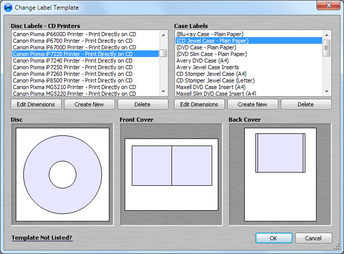

To get the correct direct disk print alignment for the Canon iP7200 please try the following:
1. Open AudioLabel, click the "Change Label Template" button, and select the "Canon Pixma iP7220 Printer" template as shown below:

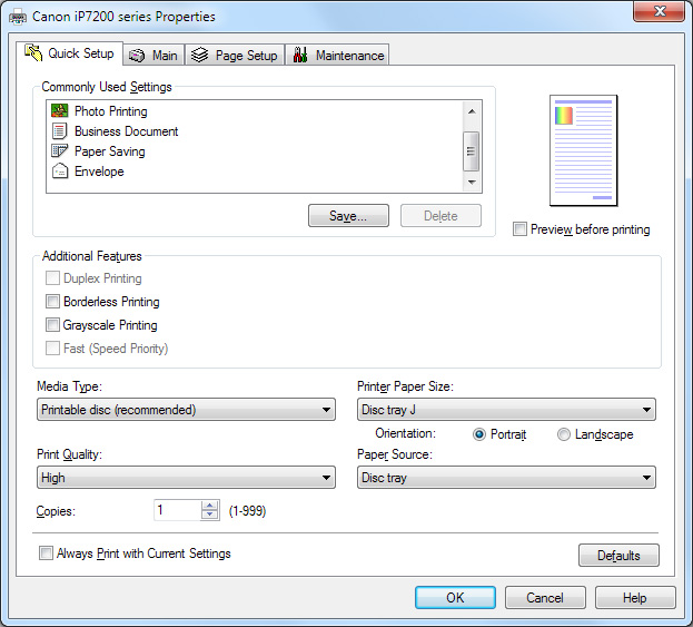

2. Next go to the "Print" dialog, click the "Printer Properties" button, and then the "Print Driver Properties" button under the direct disc section (this will open the Canon properties dialog).
3. Make sure your print driver properties are set as following:
