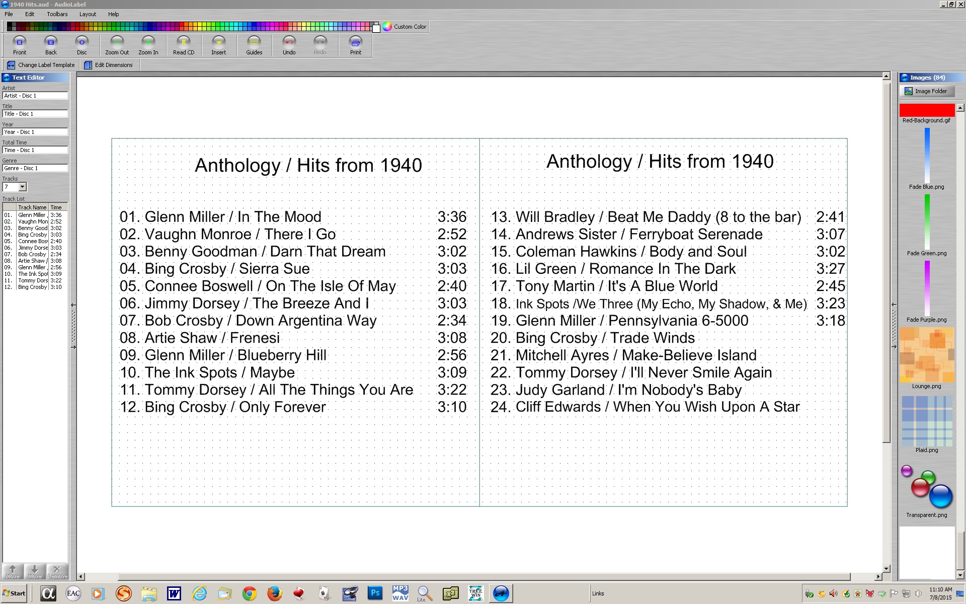

Hi. Using AudioLabel 6 (build 3) full version on windos 7 pro PC with 16Gb ram. Trying to make a front booklet for an 86 year old with poor vision for a CD that has 24 tracks. Using 14 pt arial. Have turned text linking off to allow different tracks on each of 2 pages. Got as far as track 19 typing in track number, track title/artist, and time. No matter how I try to get to the time section for track 20 I cannot get to it. Have tried clicking into the area, arrowing down and sideways with no success. Is there a workaround or fix for this? I am attaching a screen grab. Thanks for any help you can provide! Best, -Glenn

Thanks for posting the screenshot, it was very helpful. The screenshot shows that there are only 7 tracks selected on the "Tracks" dropdown box on the left side. Please change this to the number of tracks needed (and erase all the extra text for track 7).
