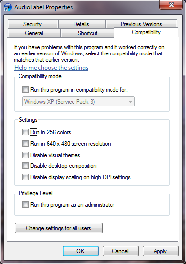

Based on what you described, it sounds like the Windows Compatibility mode for AudioLabel is set to run in 256 colors.
To check this, please right click the AudioLabel icon on your desktop. Click 'Properties'. From the Properties dialog, select the 'Compatibility' tab. As shown in the following screen shot, no settings should be checked. Please make sure the Run in 256 colors is not checked.
Please let us know if this corrects the problem.

Postby amac123 » Wed Feb 12, 2014 3:08 am
Thankyou very much - it's been bugging me for a long time
