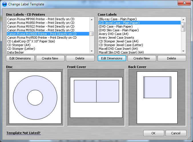

If your Canon Pro 9000 has the direct disc feature enabled, you simply need the correct settings in AudioLabel to print directly on the disc. First, open AudioLabel and select the "Canon Pixma Pro9000" template in the Change Label Template dialog of AudioLabel (shown below):

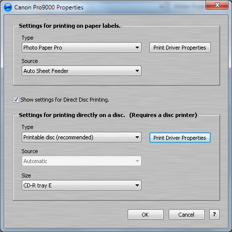

Next, open the "Print" dialog in AudioLabel and select the Canon Pro9000 in the Printers drop-down box. From there, click the Printer Properties button and set the properties as shown below:

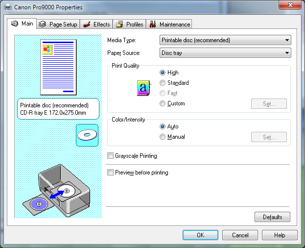

Click the Print Driver Properties button and make sure your print driver properties are set like below:

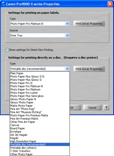

Postby sparty55 » Mon Dec 02, 2013 6:32 pm
My direct disc feature isn't enabled. In print Properties under direct disc printing, "Printable disc" isn't listed in the type drop down list and "cd-r tray E" is missing from the the size drop down list.
I tried the "instructions for activating my printer. That failed to...Now where do I go????

You might be using an older print driver. I downloaded the latest print driver from the Canon USA website here:
http://www.usa.canon.com/cusa/support/consumer/printers_multifunction/pixma_pro_series/pixma_pro9000_mark_ii#DriversAndSoftware
I installed the Canon Pixma Pro9000 Mark II print driver (version 2.70 - 10/11/13) on Windows XP and took the below screenshot.
**Please note that the Printable disc (recommended) option is at the bottom of the list (not alphabetical). The CD-R Tray E option is also at the bottom of the list. Furthermore, please make sure you have selected the Canon Pro9000 II series printer in the Print Dialog (otherwise you will see options for a different print driver).

I think we should see the same print driver options, if we install the same exact print driver on Windows XP (regardless of where the printer is from). The direct disc printing feature might work if you are able to select the correct print driver options (as shown below):
Media Type: Printable disc (recommended)
Printer paper Size: CD-R tray E
Paper Source: Disc Tray
One thing I noticed is that the Disc Tray option is not available until the Printable disc (recommended) option is selected. Also the CD-R tray E option is at the bottom of the list, and can't be seen until scrolling.

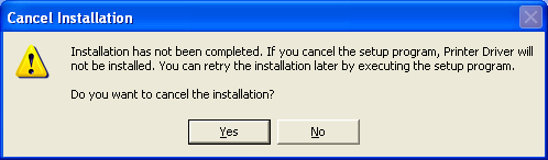

6. When asked to Cancel the Installation, select Yes (as shown below). Selecting Yes does not really cancel the installation.

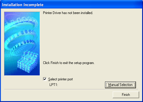

7. After the cancel screen, there is an option to manually install. Check the Select printer port option, click the Manual Selection button, and select LPT1 as your port. When all set, click the Finish button and the print driver will install.
