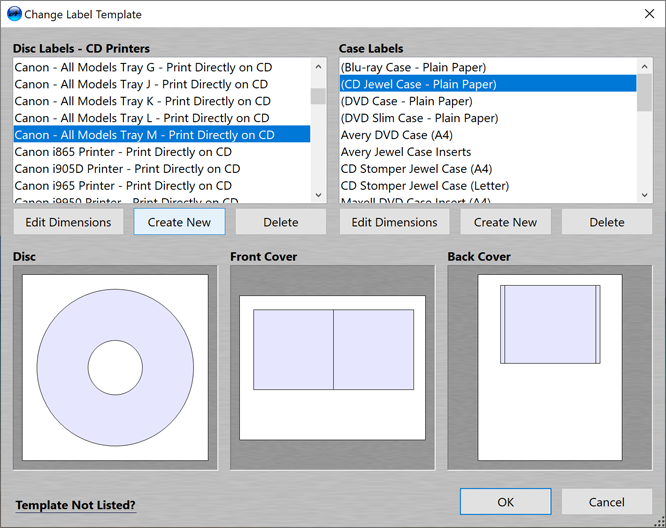

recently needed to print to a new Canon Pixma TS8360 CD printer.
My Ver6 build 6 doesnt appear have support for it?
It refers to the CD tray as the Mulit-purpose Tray, not as a "J" or "G" or any alphabet character.
Could you advise what setting would work. Is the upgrade to version & required to fix this.

We will to add the Canon Multipurpose Tray to the list of templates soon, but in the meantime you can create your own Multipurpose template.
1. First, open the "Change Label Template" dialog and select a similar template (like "Canon - All Models Tray M").
2. Next, click the "Create New" button.

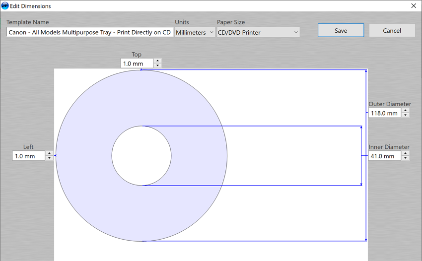

2. From here, fill out the template as shown below:
Top: 1mm
Left: 1mm
Outer Diameter: 118mm
Inner Diameter: 41mm (or 18mm for Full-Face labels)

Thanks fir the setup info Nicole,
I'll set it up manually for now.
