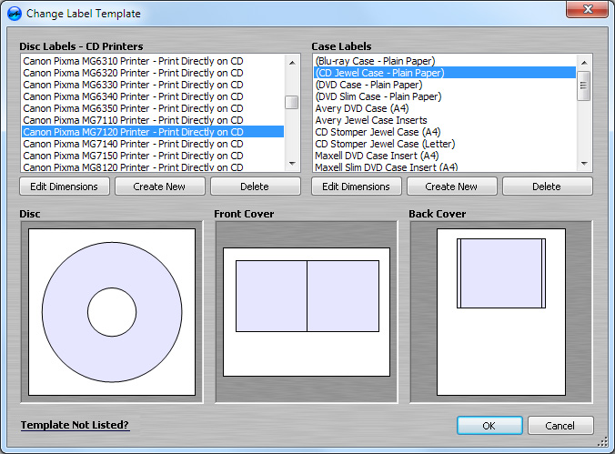

1. First make sure you have selected the "Canon Pixma MG7120 Printer" template in the "Change Label Template" dialog as shown below:

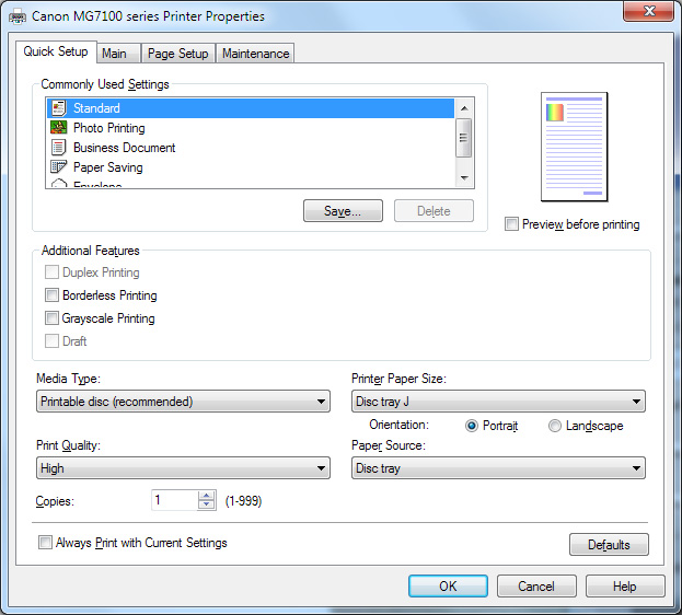

2. Next, go to the "Print" dialog in AudioLabel, click the "Printer Properties" button, and then click the "Print Driver Properties" button. (There are two "Print Driver Properties" buttons - make sure you click the one under the Direct Disc Printing.)
3. Please set the "Media Type", "Printer Paper Size", "Print Quality", and "Paper Source" as shown below:
4. Once these settings are applied, AudioLabel should print directly to the disc correctly.
