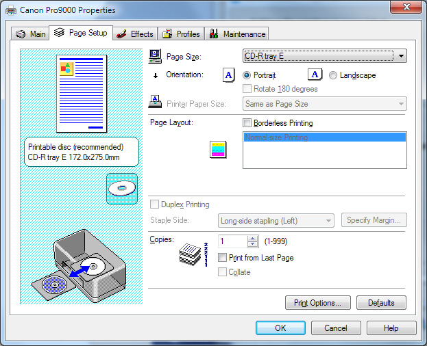

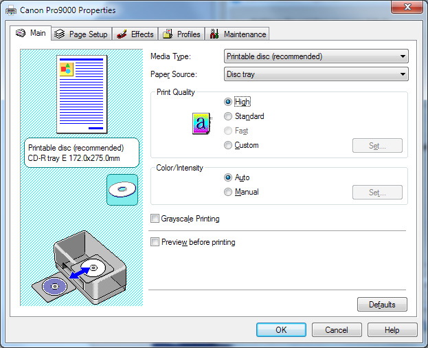

4. Please make sure your printer driver settings look like this:
5. At this point, AudioLabel should be close to the target. Please use a junk/scrap disc for testing. It's helpful to print a blank white disc with the "Print Borders" option turned on.
6. If there are problems with print alignment, please use the Edit Dimensions dialog to make manual adjustments to the Left and Top alignment dimensions.
