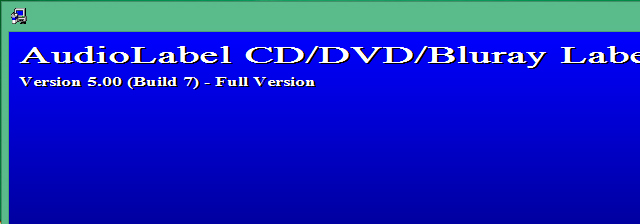

Once you run the setup file, the very first install screen should have the words Full Version (as show below):
If the first install screen does not say Full Version, then it's the trial version.

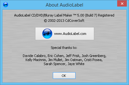

After installing AudioLabel, you can check the version by clicking "Help" on the top menu and selecting "About" (as show below):
In the About dialog, the very first line of text should have the word Registered.
If the word Registered is not there, then the trial version is installed.
